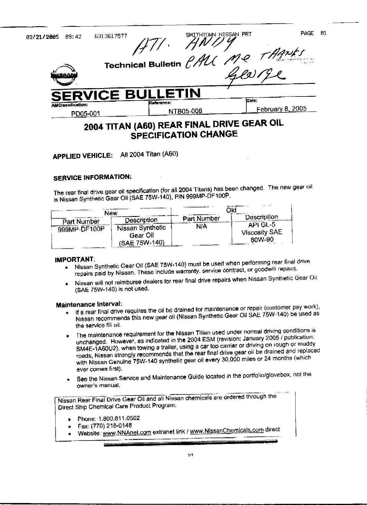

Prlauren
Joined: Jan 22 2005
Posts: 38
U.S. - New York
Posted: Feb 23 2005 at 8:39pm | IP Logged Quote Prlauren
Thought you may like to see this
Back to Top View Prlauren's Profile Search for other posts by Prlauren
sonnytimes
Joined: Oct 05 2004
Posts: 145
U.S. - South Carolina
Posted: Feb 24 2005 at 8:48am | IP Logged Quote sonnytimes
That's great information!
